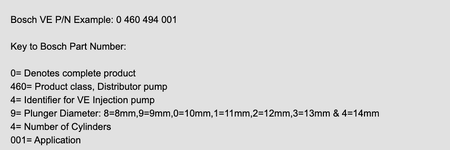

Make sure it's a Bosch with a 10mm plunger... if it's not its preferable to repair yours, you can easly get a repair kit from the web and repair it, there's also a lot of youtube videos.
Also, if you are about "top speed" you are going to loose some, if it's to tow a Bosch is better, more torque in low revs.
Here's how you can read the Bosch VE reference in order to identify the plunger size.
